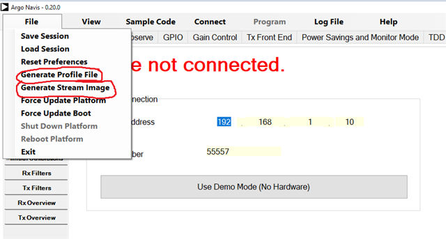

> In order to create the profile file .json and stream file .bin file with
> TES – you do not need to connect to hardware (This was not true in earlier
> versions, but I think was fixed a year or so ago).
> In TES the profile file (THE .json file) is created separately from the
> stream (.bin file).
> Those files are loaded into MATLAB via ADI’s transceiver toolbox and then
> downloaded to the target.

> We are still trying to use Transceiver Toolbox to do over-the-air
> demonstrations/development of open source transceiver designs at ORI that
> use HDL Coder/Simulink. This is a summary of where we're at with an
> ADRV9002/zcu102.

> When last we spoke, ADI's Transceiver Evaluation Software version was
> 0.23.1.
> It's now 0.24.1
