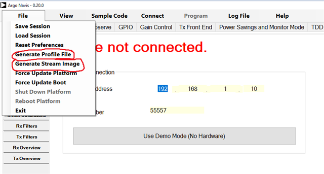

so which version of TES you should be using – depends on if you are using binary SD images from ADI (which were created in April, or if they replaced them), or if you are building the linux branch from source. TES needs to create a compatible profile (.json file) with the version of the driver you have.
In order to create the profile file .json and stream file .bin file with TES – you do not need to connect to hardware (This was not true in earlier versions, but I think was fixed a year or so ago).
In TES the profile file (THE .json file) is created separately from the stream (.bin file).
[cid:image002.png at 01DA125A.20568A70]
Those files are loaded into MATLAB via ADI’s transceiver toolbox and then downloaded to the target.
